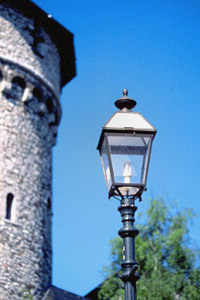

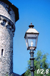

The following slide show demonstrates the visual effect in the viewfinder when pressing the Depth-of-Field preview button (DOF button) at different aperture settings using a 100mm f/2.8 based on an object distance of about 5m. The lamp is the point of focus here. Select one of the shown aperture settings and observe the effect on the background (the castle) - requires Javascript.
Viewfinder
without pressing the DOF button
Viewfinder
after pressing the DOF button
on film/sensor
(with the shutter speed set accordingly)
In the middle and right image you should be able to see that the castle gets "sharper" at smaller aperture settings due to the increased depth-of-field. The left pictures shows the viewfinder image which remains unaffected by any change of the aperture setting because without pressing the DOF preview button the viewfinder ALWAYS shows you the image at the widest aperture setting - the aperture gets only stopped down via the DOF preview button or during the exposure of the film.
