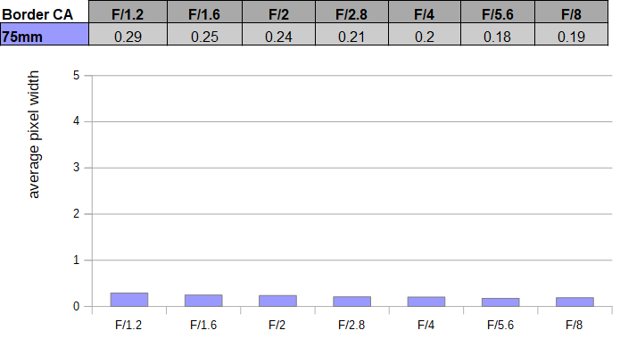

Lateral CAs are basically non-existent and nothing to worry about.

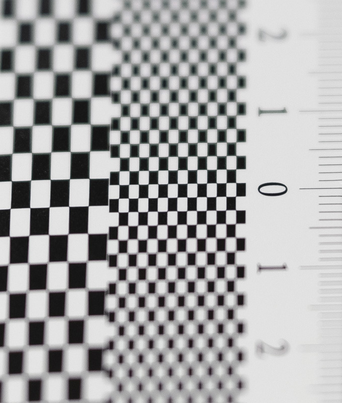

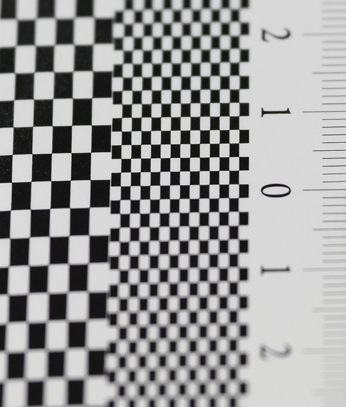

If you scroll through the aperture range, you may notice that the (fixed) focus point moves to the rear. This is a residual spherical aberration (RSA aka focus shift).
However, the "Zero" mark remains quite sharp so it's not an overly critical issue.
