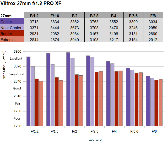

MTF (resolution) at 26 megapixels
The Viltrox 27mm f/1.2 XF Pro produces even better results than the already impressive 75mm f/1.2 XF Pro. The broader center quality is already excellent at f/1.2. However, even more surprising is the good to very good result of the outer image field. Stopping down to f/1.6 doesn't make a hell of a difference, but there's a slight boost at f/2 with the borders/corners now residing firmly on very good levels. The peak quality is reached around f/2.8. Diffraction has an impact from f/8 onward. As usual, aperture settings beyond f/11 should be avoided unless required for the shot.
The field curvature is low. The centering quality of our sample was Okay, with a tad softer results on the right image side (slightly visible in 40mp images).
Below is a simplified summary of the formal findings. The chart shows line widths per picture height (LW/PH), which can be taken as a measure of sharpness.
