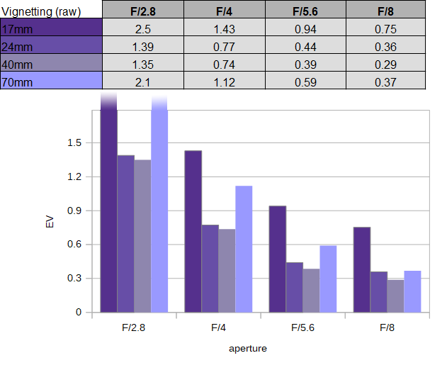

The RAW vignetting reveals that there's quite a bit of correction necessary, especially at the extreme ends of the zoom range. While a light falloff of more than 2 EV (f-stops) wouldn't be all the unusual if it was a full format lens, it's off our charts in the APS-C scope. Keep in mind that vignetting correction comes at the cost of increased image noise.
