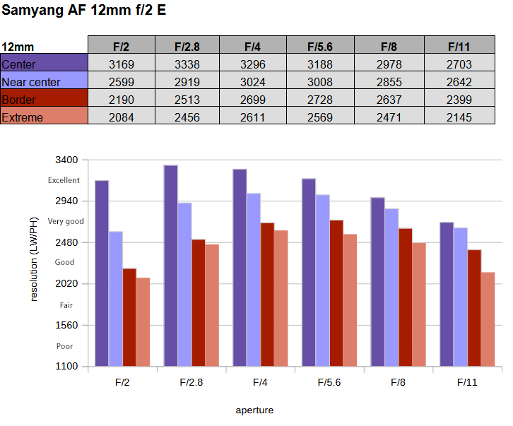

The Samyang lens is capable of producing very good results in our MTF lab. At f/2, the center resolution is already excellent, and the outer image field is at least on a good level - albeit just. For an extra kick, you should, however, stop down to f/2.8, in which case the borders/corners recover nicely already. The global peak performance is reached between f/4 and f/5.6 with still excellent center quality and very good corners/borders. Beyond diffraction takes its toll, and f/11 should be avoided already.
The field curvature is very flat - which is indeed good for astrophotography. The centering quality of the tested sample - often a weak aspect with Samyang lenses - was Okay.
per picture height (LW/PH) can be taken to measure sharpness.
