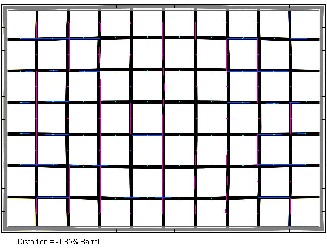

While the Viltrox AF 20mm f/2.8 FE features a correction profile, it doesn't include data for distortion correction (at this point). Thus, you'll have to live with the native distortion characteristic here. Technically, the barrel distortion is quite low for such a lens at 1.85%. However, it shows a wavy subfrequency. This is irrelevant for landscape photography, but you may notice this in city scenes.

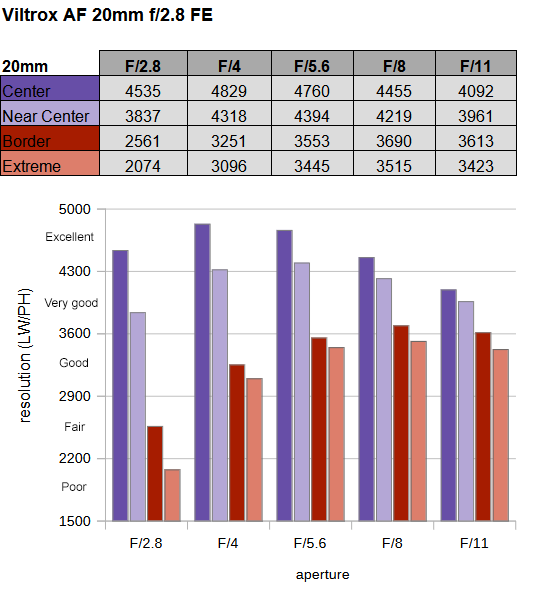

In terms of resolution, the Viltrox lens surprises with very high MTF figures ... with a caveat. The test chart below illustrates the performance on the focus plane.
The center performance is already excellent at f/2.8. There's a fairly strong drop from here, and the near center is "only" very good (just). The outer image field is still fine, with good to very good results.
There's a noticeable boost in the broader center when stopping down to f/4. The overall peak performance is reached at f/5.6, where the borders/corners also achieve very good results.
Beyond diffraction takes its toll, and you shouldn't stop down beyond f/11 unless needed.
Below is a simplified summary of the formal findings. The chart shows line widths per picture height (LW/PH), which can be taken as a measure of sharpness.
