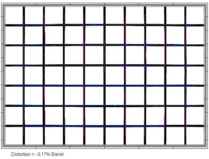

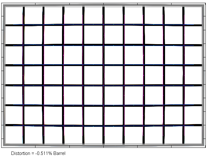

While the zoom range of the Tamron 17-50mm f4 Di III VXD may appear to be moderate, the related change of view is actually quite extreme at 103°41' to 46°48'. Thus, it can't come as a surprise that the lens struggles with respect to image distortions - at least in RAW files. At 17mm, the barrel distortion exceeds 7%, and it's still a very hefty 5% at 20mm. The issue has eased quite a bit at 28mm (0.5%), and it's gone at 50mm.
Of course, these distortions are mostly hidden from the user due to auto-correction - see below.
