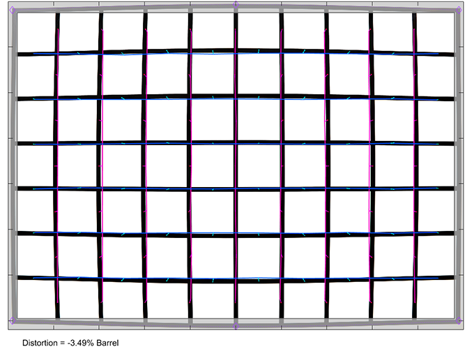

The Tamron SP 24-70mm f/2.8 Di VC USD G2 produces a varying degree of distortions throughout the zoom range. At 24mm there is a clearly visible barrel distortion of 3.5% which is a little higher than average for a lens in this class. Distortions are negligible around the 35mm mark but increase again towards the long end of the range. At 70mm you have to live with medium pincushion distortion.

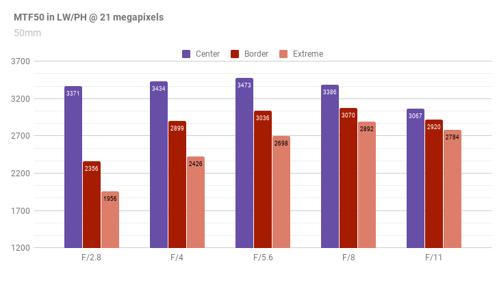

MTF (resolution) at 21 megapixels
Why are the MTF numbers sometimes "better" on 21 megapixels compared to 50 megapixels ? There are two reasons for this. Lateral CAs are lower in terms of pixel widths at 21mp simply because the pixel density is also lower. Extreme CAs that may exist at 50mp are therefore less affecting the measurements at 21mp. Generally, we are also using a certain degree of sharpening during the image conversion (just like in real life images) and because the 21mp results are "sharper" on pixel level they are relatively more receptive to (mild base-) sharpening.
Many users are still using cameras with a more moderate pixel count so let's have a look how the lens performs with the eased requirements at 21 megapixels - also for comparing the results to older (EOS 5D II) reviews.
Unsurprisingly, the performance is better on a per-pixel level. However, the corner quality is still not hot at f/2.8 albeit the borders are at least acceptable. Stopping down to f/4 solves most of the corner issues and the sharpness is pretty impressive at medium aperture settings.
