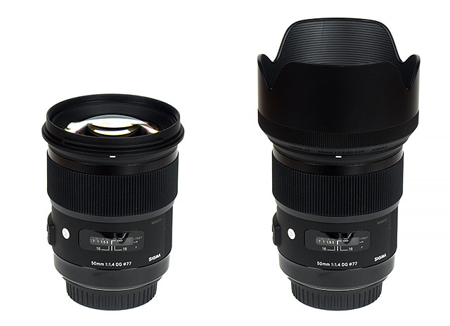

Sigma's "Art" series tend to have a superb build quality and the 50mm f/1.4 is no exception to the rule. Besides some metal parts, Sigma uses a new material called TSC (Thermally Stable Composite) which contributes to the high quality perception. The broad focus ring is nicely rubberized and operated smoothly. Thus everything screams premium here really although some may still struggle to believe this. To ease the non-believers - the lens hood is still made of plastic though. ;-) Other than that it is a brick really - it has almost the triple weight and double size of the "pre-war" Canon EF 50mm f/1.4 USM but compared to the Zeiss Otus this is still "compact".
The physical length of the lens remains constant at all focus settings and the front lens does not rotate during focusing. So, using a polarizer is no problem. The lens features HSM, which is Sigma's version of ultra-sonic drive. Typical for many HSM lenses, the AF is virtually silent and very fast at least in conventional phase-detection AF mode. Contrast AF in Live-View mode isn't that hot. The lens is also compatible with Sigma USB dock so you can tune the AF calibration at will if you see the need and are willing to invest a little extra.
