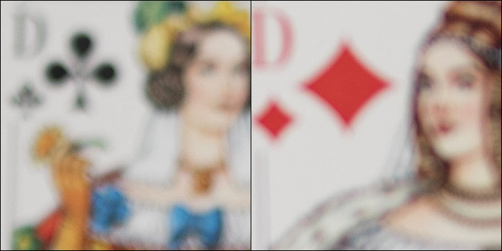

LoCAs (non-coinciding focal planes of the various colors) are a common issue with relatively fast glass. As you can notice below the halos have different colors - magenta (red + blue) in front of the focus point and green beyond. Truly "apochromatic" lenses don't show LoCAs but these lenses are very rare especially below 100mm. Unlike lateral CAs, LoCAs cannot be fixed easily in post processing.
Typical for most ultra fast primes the Sigma shows a certain amount of bokeh fringing at large aperture settings but the result is above average here again. The fringing can be reduced by stopping down and it's mostly gone from f/2.8 onward.
In addition, these shots also illustrate that there is virtually no focus shift when stopping down.
