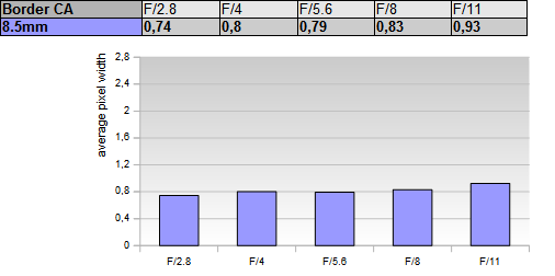

Lateral CAs (color shadows at harsh contrast transitions) are just slightly visible with an average pixel width of around 1px at the image borders. This is not disturbing though.
