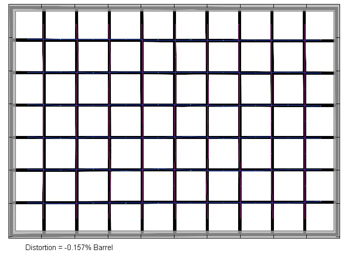

On the Z50, the lens takes advantage of the reduced size of the DX sensor and produces a small amount of barrel distortion at around 0.4%. With optional in-camera software correction enabled, distortion is reduced to around 0.16%.
