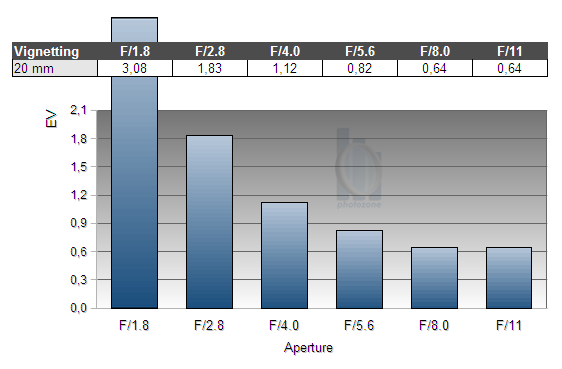

The lens shows massive amount of light fall-off towards the corners at large apertures. Wide open, the corners darken more than 3 EV, which is well beyond our scale. As usual stopping down reduces the issue, but even at rather small apertures there is still more than half a stop of vignetting left.
