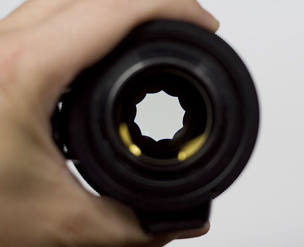

As you can see below the aperture mechanism doesn't really produce a "circle" when stopping down. However, the quality of the bokeh (the out-of-focus blur) is actually quite Ok.
