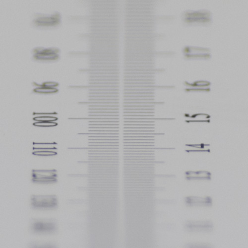

Bokeh fringing shows up as magenta colored halos in front the focus point and green beyond. The Pentax lens shows only a slight amount at f/4 and the issue is largely reduced at f/5.6 and gone by f/8.
| f/4 |
f/5.6 |
f/8 |
