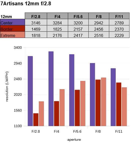

The resolution characteristic is quite good albeit of course, not without flaws. The center quality is excellent straight at f/2.8. The borders/corner are soft at this setting though. Stopping down boosts the quality and you can expect a good outer field at f/5.6. Interestingly the corners are better than the borders throughout most of the range - this is quite rare. The sweet spot is at f/8 with good to very good results at the borders/corners. Diffraction has a higher impact beyond f/11. f/11 remains quite usable though.
