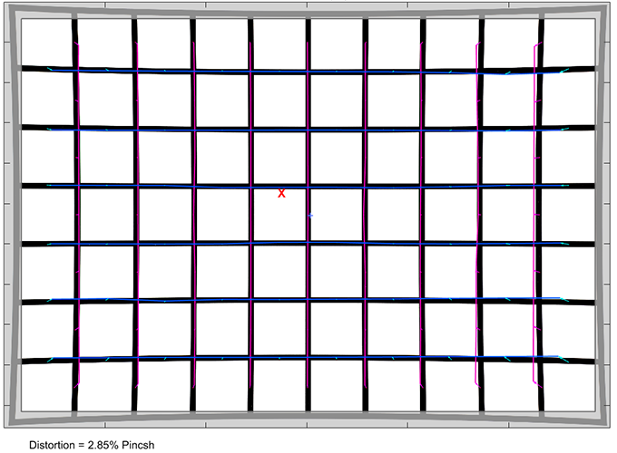

Unfortunately, the technical analysis has to start with a weakness of the lens - image distortion. The original characteristic is hardly impressive with a pincushion distortion in excess of ~2.8%. This is rather extreme for such a prime lens.
Of course, in real life, this may be a lesser issue if you keep image auto-correction activated. Surprisingly it just eases the issue but doesn't eliminate it completely. However, at just 0.6% it's not really something to worry about.

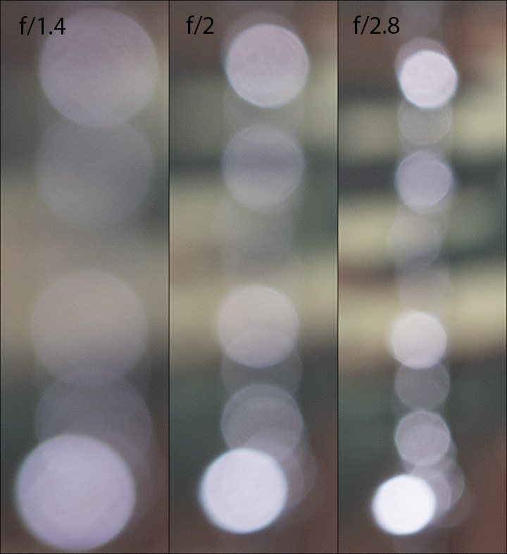

"Bokeh" is a Japanese word referring to the way, out of focus blur is rendered. There are two main aspects - out-of-focus (background) highlights and the rendering of contrasty objects in the focus transition zones. If you buy a lens such as the 56mm f/1.4 DC DN, you will usually target shallow depth-of-field applications thus the bokeh isn't a secondary criterion here.
Let's have a look at the "highlights" first - and they are almost perfect in the image center at least. The inner zone of the discs is very clean and there is no outlining to speak of. The discs are circular at f/1.4 and (mostly) f/2. The more edgy aperture shape starts to emerge at f/2.8.
When looking at the whole image frame, the situation is a little different though. As you can see below, a fully circular highlight shape is only maintained near the image center. The shape deteriorates towards "cat eyes" from the midfield into the corners. This is a mechanical vignetting effect from the lens barrel but it sets in a little "early" here. Stopping down broadens the "good" zone in the center but cuts the corner highlights. A circular shape in the corners is mostly restored at f/4 (not shown).
The general rendition of out-of-focus areas is silky smooth in the critical image background (shown to the left below). The foreground blur (to the right) is a tad more edgy but still very good.
Bokeh Fringing (LoCA)
Bokeh fringing - also referred to as LoCAs - is a color fringing effect on the Z-axis. It shows up as purplish halos in front of the in-focus zone and greenish beyond. The effect is visible at f/1.4 and f/2 and starts fading at f/2.8 - this is a typical behavior for a non-APO lens.
