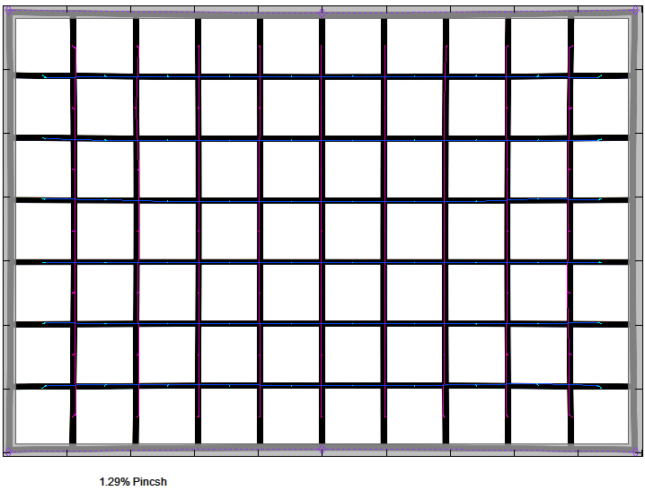

As a user you can select whether your images shall be auto-corrected or stick to the original quality of the lens. In auto-corrected mode, there is, unsurprisingly, nothing to worry about (at the expense of field-of view). However, the situation changes when looking at the original characteristic of the lens. It shows a rather heavy ~3.1% barrel distortion at 16mm and moderate pincushion distortion at and beyond 40mm. The two opposing forces even out around the 24mm mark. This is about typical in this lens class though.
