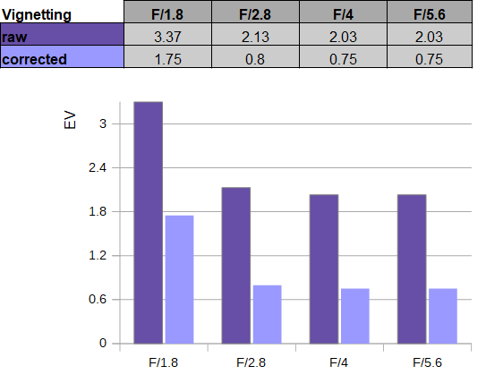

Ultra-wide lenses have a degree of "natural vignetting" anyway and it shows. At f/1.8 it is very heavy with a light-falloff of ~3.4 EV (f-stops). Stopping down to f/2.8 reduces this to just over 2 EV. Thus image auto-correction should come to the rescue here. It reduces the vignetting to an acceptable ~1.7EV at maximum aperture and a very manageable 0.8EV from f/2.8. This increases the sensor noise in the outer image field accordingly.
