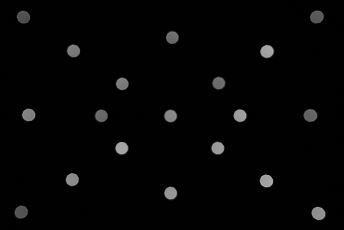

A fast prime lens is nothing without a good bokeh, and this is clearly a strength of the Meike lens. Out-of-focus highlights have a silky smooth inner disc with just a tad of outlining at the edges of the discs. The circular shape starts to deteriorate with the more edgy aperture shape when stopping down.
The circular shape is maintained in a very broad zone at f/1.8. As usual, they deteriorate in the corners. Strangely, these outer "discs" have a somewhat irregular shape. This also applies to f/2.2. At f/2.8, the outer discs have been mostly restored.
