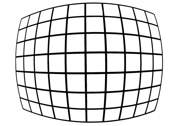

The fisheye effect of the DA 10-17mm cannot be measured via the Imatest toolkit but the reference images below should give you an idea about the degree of barrel distortion - remember that the lens is supposed to produce such a high degree of distortion. This is not a design problem.

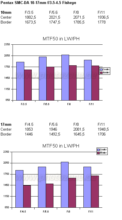

Testing a fisheye lens is a bit experimental. The Imatest toolkit freaked out regarding all the wild curves at the image borders at the 10mm setting. The 17mm MTFs should be quite accurate whereas the border resolution figures at 10mm should be only taken as a very rough guidance.
Keeping this in mind the Pentax SMC-DA 10-17mm f/3.5-4.5 ED[IF] Fisheye produced good to very good results in the lab. At 10mm the center performance is already very high at wide-open aperture and the borders follow not far behind. Stopping down produces only marginally sharper results. The local sweet spot is at f/8. At 17mm there's a performance drop - not in the center but the borders suffer a bit. The situation is better at f/8 or f/11 where the border quality recovers to good+ levels.
The Tokina variant in Nikon mount performed somewhat better so the tested sample may not have been the very best one.

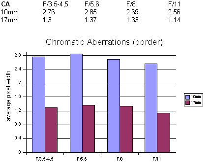

Lateral CAs (color shadows at harsh contrast transitions) can be quite a problem with the DA 10-17mm Fisheye. At 10mm the lens produces a quite excessive amount of border CAs (2.5+ pixels) whereas the situation isn't quite as bad at 17mm (~1.3 pixels). Please note that lateral CAs are correctable via imaging tools.

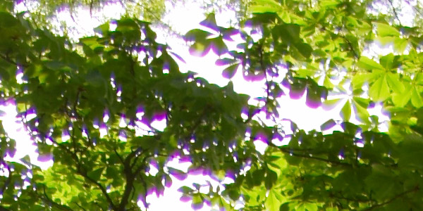

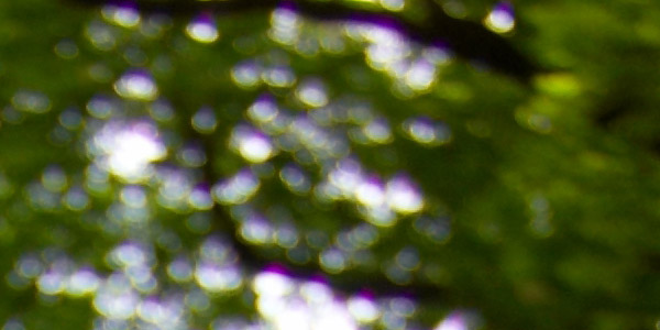

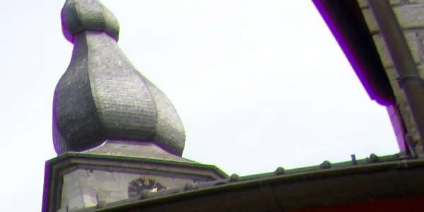

Purple Fringing
Lateral CAs may not be good but the really bad characteristic of this lens is purple fringing (a color blooming effect at extreme contrast transitions). At the time when I took the lens for a ride it was an overcast day which is among the worst situation when it comes to purple fringing due the extreme contrasts between your subject and the sky. Here're a couple of 100% crops which should illustrate the potential degree of the problem.
