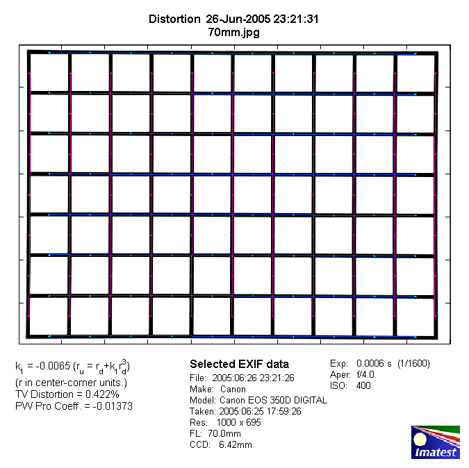

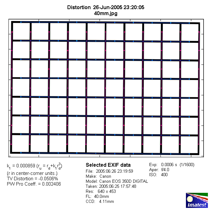

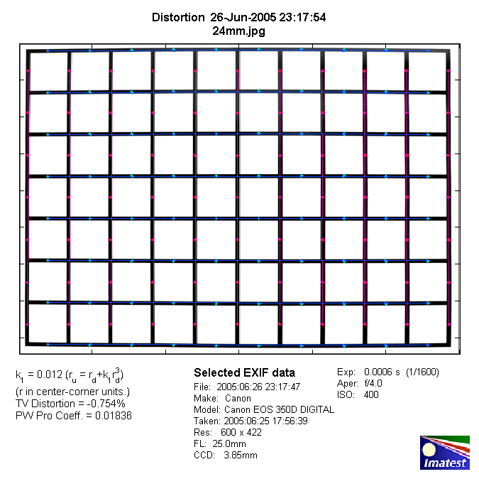

The level of distortion is very low for a standard zoom lens with
very slight barrel distortion at 24mm and marginal pincushion distortion
at 70mm. At 40mm there is no distortion at all. Really a great performance here for a zoom!
24mm:
40mm:
70mm:
