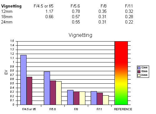

Typical for many ultra-wide zooms the Sigma also suffers from vignetting problems
which are most pronounced at the 12mm setting where they exceed 1EV so even the
APS-C crop factor doesn't help here. Stopping down to f/5.6 and beyond helps
to control the issue. At 18mm and 24mm vignetting is no significant problem
anymore.
