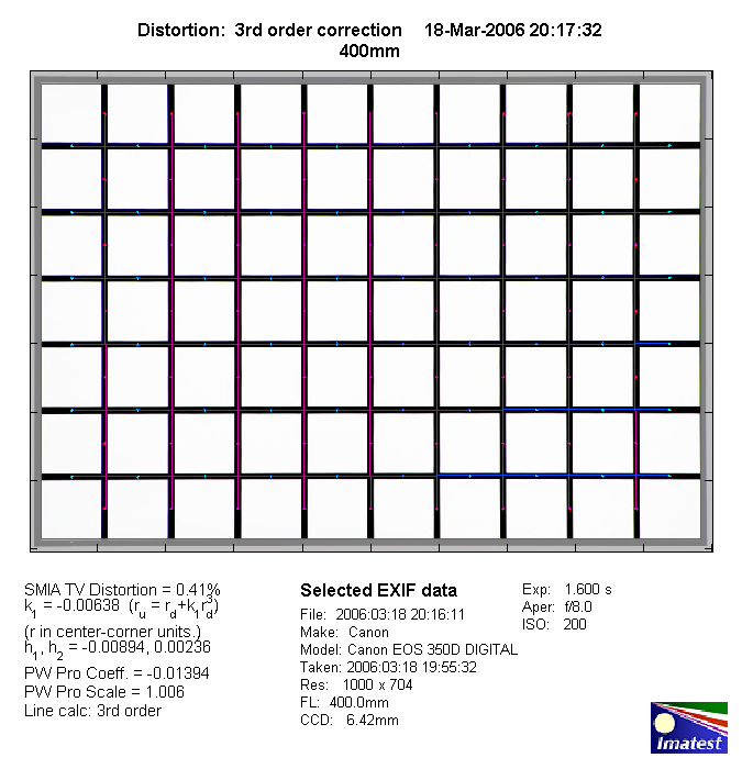

Distortion is very well controlled with this lens with marginal pincushion distortion at 80mm increasing to slight pincushion distortion at 400mm. This is nothing that you need to worry about in the field.

400mm:
