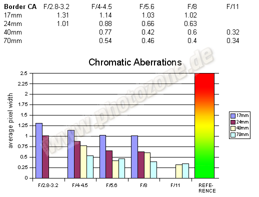

Chromatic aberrations (color shadows at harsh contrast transitions) are slightly better than average for a zoom lens in this class. CAs are somewhat pronounced at 17mm peaking in an average width of 1.3 pixels at the image borders. The problem eases significantly when moving towards the long end of the zoom range.
