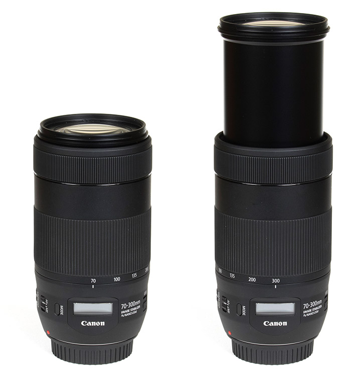

The build quality of the lens is pretty good for a consumer grade lens. It follows the same new (outer) design philosophy that we have seen in the EF-S 18-135mm f/4.5-5.6 USM IS. It doesn't look overly exciting in our opinion but your mileage may vary. Anyway, the lens body is made of good quality plastic based on a metal mount. The zoom and focus rings are rubberized and offer a quite smooth action. The lens extends when zooming towards the long end of the range. However, unlike on its predecessor, the inner tube does not rotate during focusing. A transport lock is provided. A curious new little feature is an LCD display on the lens. First seen on Zeiss Batis lenses (albeit in OLED variant here), it provides information about focal length, focus-distance or depth of field. Whether this is useful on this specific lens ... well ... it doesn't hurt anyway.
Another very obvious difference compared to the mk I is the focusing speed. It is BLISTERINGLY fast and easily as fast as the fastest Canon lenses that we have tested to date (yes, believe it or not). The AF motor changed from a slow micro-USM to Canon's brand new Nano-USM. Nano-USM is also dead-silent. Nano-USM has one side-effect though - in manual focusing mode there's no mechanical coupling anymore thus you are driving the AF motor when turning the focus ring. However, we don't consider this to be a drawback.
