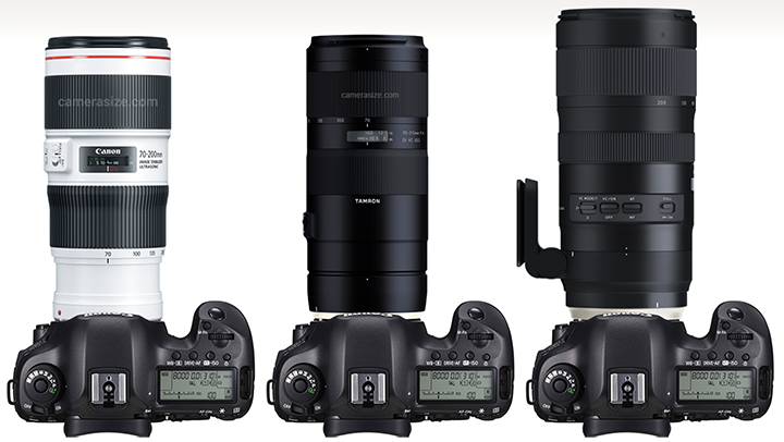

There is a variety of alternatives out there. You should still be able to shop for the mk I for a while and even the ancient Canon EF 70-200mm f/4 USM L (without image stabilizer) is still available here and there - and that's an oldie but goodie as well at a much lower price point. As far as current production lenses are concerned, the most obvious competitor is the new Tamon 70-210mm f/4 Di VC USD. We haven't tested this lens yet but Tamron doesn't classify it as an "SP" lens - their professional grade lineup - so it is very unlikely that it can touch the Canon EF 70-200mm f/4 USM L IS II really. However, it is also much cheaper at just 800USD/EUR. An option that may produce more headaches regarding your preference may be the Tamron SP 70-200mm f/2.8 DI VC USD G2. We haven't tested this one either but that one is certainly a serious lens and it resides at the same price point as the Canon lens but it is one stop faster. However, as it goes with f/2.8 lenses, it is also much bigger and heavier.
