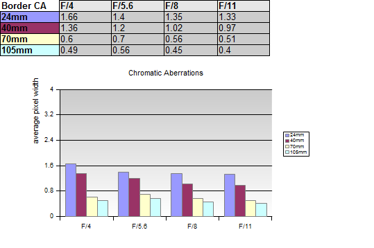

Lateral chromatic aberrations (color shadows at harsh contrast transitions) are comparatively moderate with a peak of 1.6px at 24mm f/4. The CA decrease when stopping down and they aren't quite as pronounced in the medium to upper focal length range.
