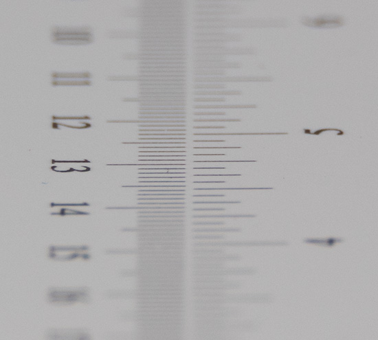

As far as the general out-of-focus blur is concerned - the background is quite smooth (left-hand sample crop below), a bit less so in the less critical foreground blur (to the right).
The so-called bokeh fringing refers to colored halos in the focus transition zone. Hard contrasts can have a purple color tint in the foreground, changing to greenish beyond the focus point. However, this aspect is mostly an issue for ultra-large aperture lenses and the slow speed Sigma isn't really affected by this even at max. aperture.
