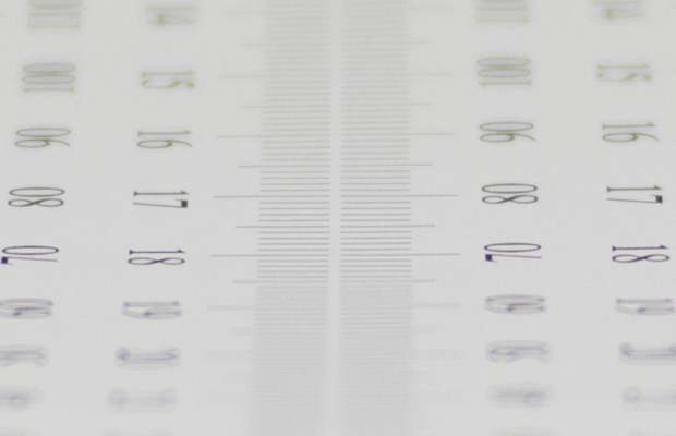

LoCAs (non-coinciding focal planes of the various colors) are a common issue with relatively fast glass. As you can
notice below the halos have different colors - magenta (red + blue) in front the focus point and green beyond. The Lanthar is not perfectly corrected at f/3.5 but the problem is gone from f/5.6 onwards.
f/3.5 |
f/5.6 |
