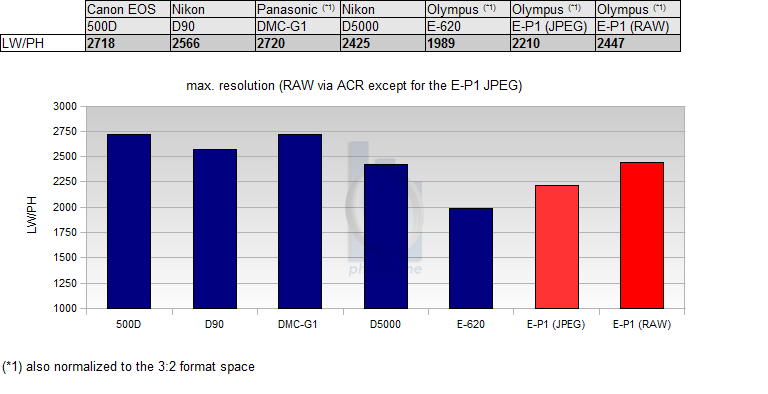

As Klaus always mentions, Olympus DSLRs are rather complicated beings with respect to their effective sensor resolution due to the implementation of a very strong AA filter ("Anti-Aliasing" or low-pass filter). The other manufacturers are also using AA filters (except Leica and Sigma) but the current trend is to use rather weak ones because a strong AA filter works out fine for eliminating moiree effects, however this has a negative impact on the resolution characteristic. Let’s check if the resolution of the PEN meets Klaus’s demands.
The following chart compares the RAW and JPEG output of the Olympus E-P1 to the last OpticalLimits camera tests of the Canon 500D, Nikon D90 and D5000, Panasonic DMC-G1 as well as Olympus E-620. The results are based on RAW files, transformed to DNG and converted to JPEG, using the same Adobe Camera RAW version.

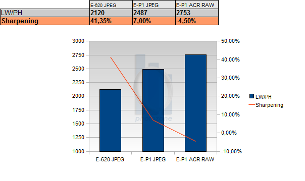

The maximum resolution of the PEN's raw files is about average and on a par with the Nikon D5000. However the JPEG output is a good deal worse and no appropriate option if maximum resolution is needed. Nevertheless, Klaus will be very glad about the effective resolution compared to the Olympus E-620 which indicates a rather weak AA filter on the Olympus E-P1. This fact is reconfirmed by the following chart which shows the higher effective resolution of the PEN despite the obvious lower sharpening level.
As already mentioned in our Review of the Olympus E-620, Olympus applies a heavy amount of sharpening during the post-processing of the straight JPEG output. Fortunately this is not the case with the PEN and due to the weaker AA filter the effective resolution increased dramatically while lowering the sharpening level. Additionally, comparing to the JPEG-  the “undersharpened“ RAW-output of ACR contains even more scene information at a lower sharpening level. However, it's quite interesting to see that the small 2,25cm² sensor of the PEN provides almost the same effective resolution compared to the comparatively big 3,73cm² sensor of the Nikon D5000. Let's check the impact of the pixel density of around 5.1 MP/cm² on the dynamic range...
