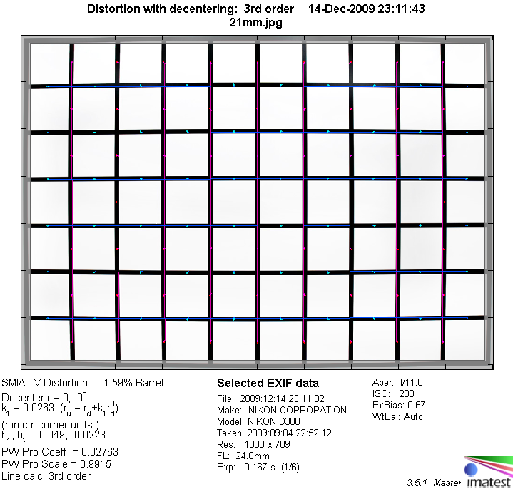

The lens shows moderate barrel distortion of around 1.6%. This can be visible and disturbing for subjects with straight lines near the image border. However, the distortion is almost uniform and thus easy to remove in post processing.

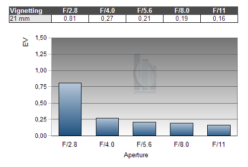

Wide open the lens shows moderate light fall-off towards the corners of around 0.8 EV. Stopped down to f/4 and beyond, vignetting is no longer field-relevant.

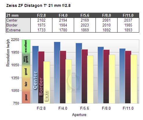

The lens delivers impressive sharpness across the whole frame at all tested apertures.
Center and border sharpness is excellent at any aperture, from wide open down to f/11 (where diffraction already reduces resolution). The corners follow only slightly behind with very good sharpness.

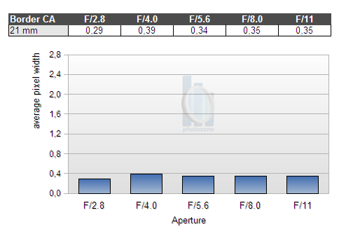

Lateral CAs (color shadows at harsh contrast transitions) are very well controlled at less than 0.4px on the average at the image borders. This is pretty much negligible in field conditions.
