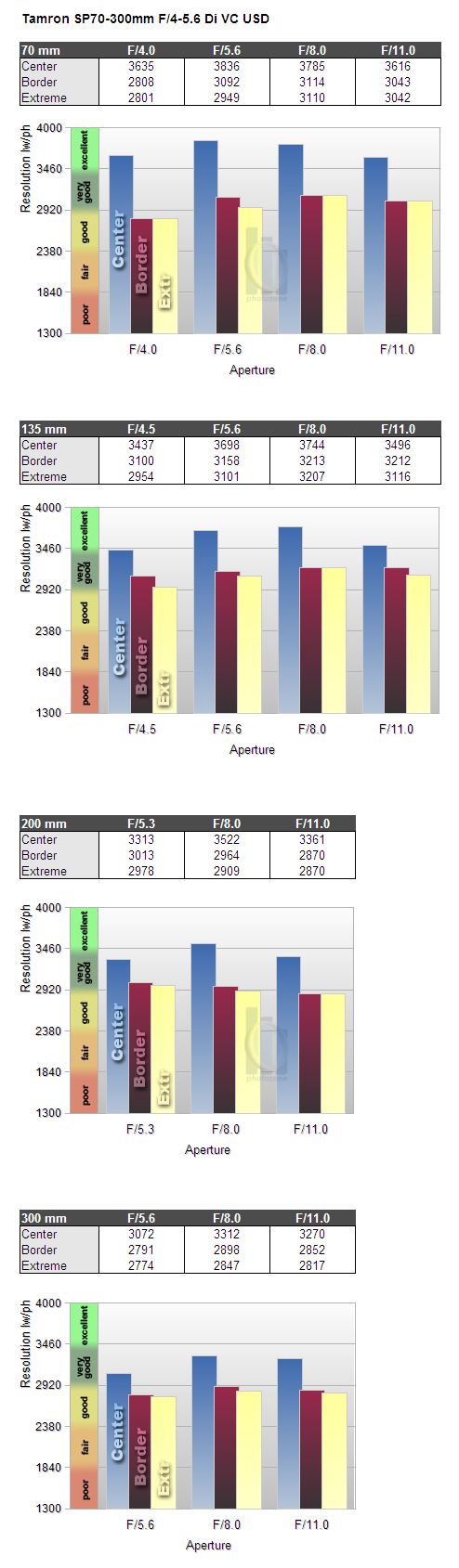

The resolution characteristic is pretty good but not outstanding. The center quality is excellent at 70mm whereas the border/corner quality varies around the good to very good mark. This pattern is also valid at the longer focal lengths albeit based on slight reduced, but still very good center. It is also worth to mention that the contrast is comparatively punchy at 300mm - even at max. aperture. This is clearly a differentiator compared to other lenses in this class.
