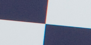

Lateral CAs are usually easy to correct during post-processing but for whatever reason this aspect is not auto-corrected. This is insofar surprising because the M.Zuiko has quite a problem here with an average CA pixel width of up to 3px at the borders. Let's hope that this issue will be corrected via a firmware update soon because this is disturbing indeed.
Here's a sample crop illustrating the problem:
