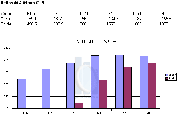

As you can see below the Helios shows us a wild ride in terms of resolution.
The inner center resolution is good at f/1.5 but the quality collapses beyond.
There's only some sort of color soup left at the borders. At f/2 and f/2.8
the usable center portion broadens and the quality reaches very good levels
here whereas the borders are still dismal. At f/4 the center quality reaches
excellent levels and the borders get finally boosted to good quality.
At f/5.6 and more so at f/8 the image quality is very good.
