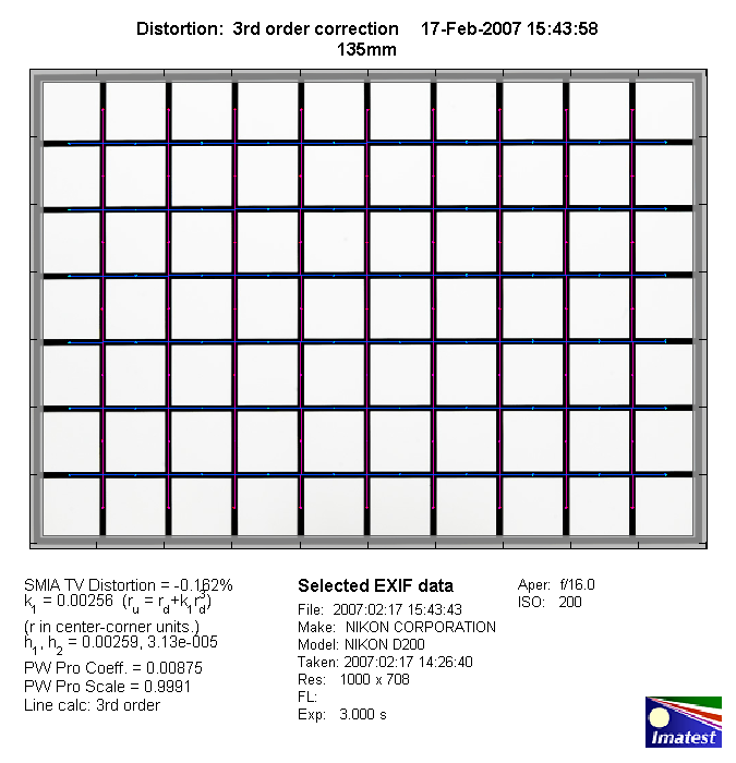

The DC-Nikkor shows an extremely low level of distortion (0.16%) which is absolutely negligible in field conditions.

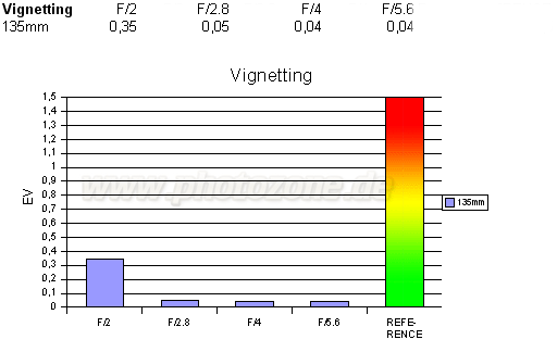

Thanks to the sweet spot behavior on the D200 vignetting is very well controlled and it is generally no problem to use this lens even at the max. aperture setting (f/2).

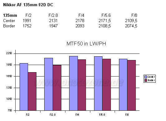

The resolution figures are already very good at f/2 and increase to excellent levels beyond. The sweet spot is reached between f/4 and f/5.6. This applies to R=2 which is the sharpest setting according to the manual.
With activated Defocus Control (other than f=R or F) the corresponding image softening also affects the resolution and contrast performance to varying degree but by doing so the quality of the bokeh is of primary interest and less so the sheer resolution.

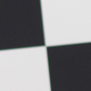

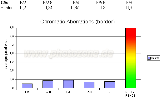

Lateral chromatic aberrations (color shadows at harsh, in-focus contrast transitions) are very low at around 0.4px on the average at the image borders.

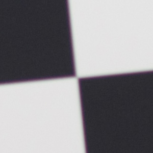

Typical for many ultra-large aperture lenses the DC-Nikkor suffers a bit from Longitudinal Chromatic Aberrations (LoCA) resulting in greenish and reddish out-of-focus edge transitions.
