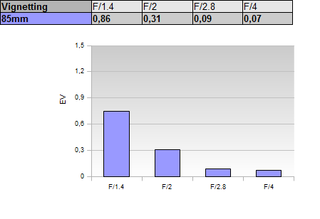

The Sony 85mm f/1.4 is a full format lens and as such it is enjoying the usual sweet spot advantage when used on an APS-C camera. Within this scope the lens shows a lesser degree of vignetting at f/1.4 (0.9EV). This is actually higher than what we have seen in our A700-based test. Whether this relates to the sensor or a different tone curve is hard to tell. Such a light falloff is not extreme but certainly visible in critical scenes. The problem is basically negligible from f/2 onward.

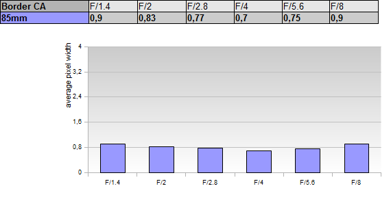

Lateral chromatic aberrations (color shadows at harsh contrast transitions) are well controlled with an average pixel width around 0.8px at the image borders. Generally this is nothing to worry about albeit slightly higher than we expected.
