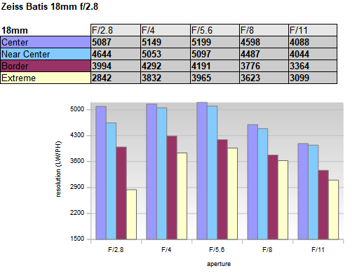

The Zeiss Batis 18mm f/2.8 has a highly impressive resolution characteristic. The center and near center is tack sharp at f/2.8. The border quality is also very good at fully open aperture whereas the far corners are just Ok here. Stopping down to f/4 improves the center zone even further and also lifts the corners to very good levels. The corner do still improve a little at f/5.6. Diffraction effects kicks in at f/8 and gets noticeable at f/11. That may be a little surprising but f/8 should be good enough for "infinity scenes" anyway. Avoid f/16 and beyond.
The centering quality of the tested sample was very good. Field curvature is very low for an ultra-wide lens.
Note: There was an error with the center values at f/8 and f/11 (corrected).

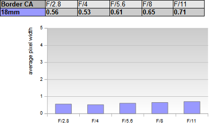

The Zeiss lens produces a very low amount of lateral CA (color shadows at harsh contrast transitions) starting with an average CA pixel width of 0.5px at f/2.8 and a maximum of 0.7px at f/11. This is unusually good for an ultra-wide lens.
