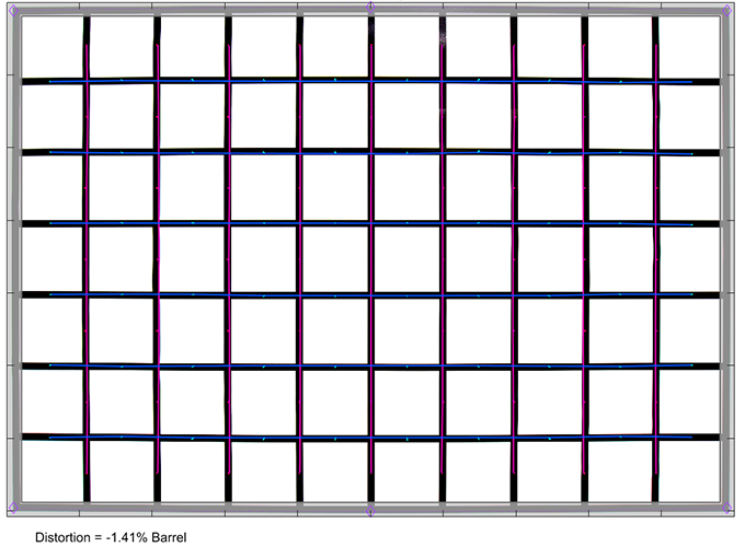

Laowa advertises the 15mm f/2 as "Zero-D" or "Zero Distortion" lens. That's not quite true but at just 1.4% the amount of barrel distortion is very low indeed in this lens class.
