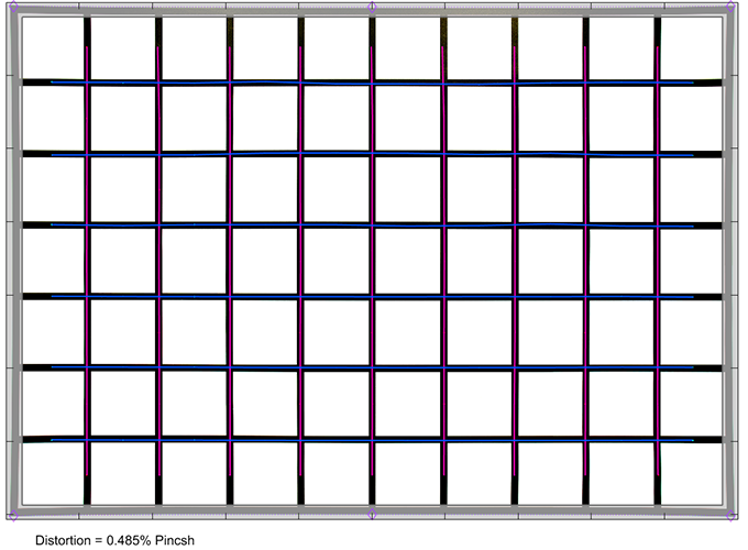

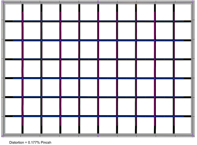

Many "mirrorless" lenses aren't fully corrected in terms of image distortions. However, Sony went the extra mile with the Sony FE 24mm f/1.4 GM. With a pincushion distortion of just under ~0.5%, there's already nothing to complain about in RAW mode. The remaining traces can be eliminated in auto-correction mode.

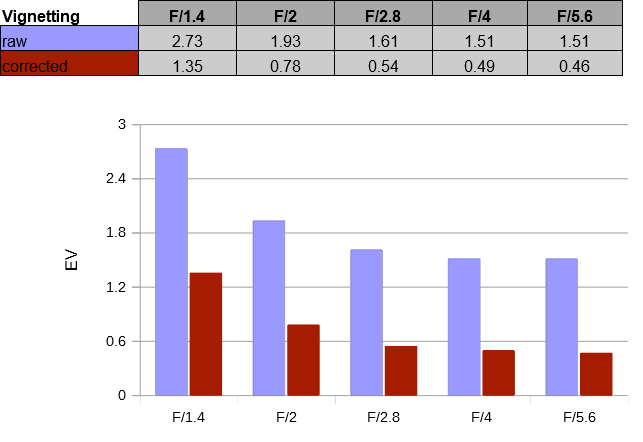

Vignetting can be an issue in RAW mode and it is somewhat worse than usual in this lens class. At f/1.4 the light falloff is rather massive at 2.7EV (f-stops). Stopping down helps, of course, but the vignetting remains visible at around 1.5EV - probably a side effect of the rather small front element and an indication that Sony is relying on its image auto-correction capabilities in this respect. With activated auto-correction, you can still spot some light falloff at f/1.4 albeit it's far from being extreme in this case. The issue is pretty much negligible by most standards from f/2.8 onward.

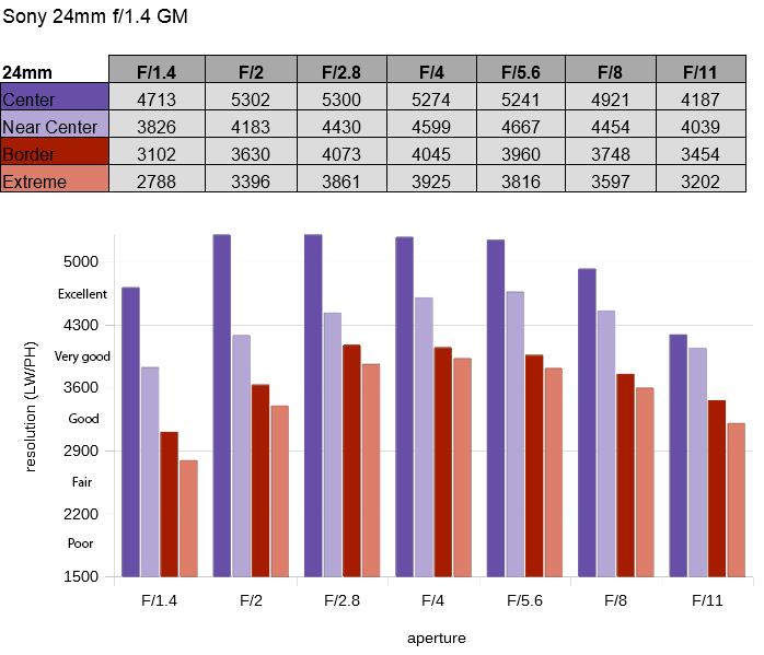

The resolution characteristic is very impressive for such a fast lens. Typically f/1.4 lenses struggle at fully open aperture but the Sony lens manages to maintain a decent level of quality. The image center is dead sharp here and the near-center is very good. The borders/corners are, of course, softer but they don't dive into a deep abyss at least. Stopping down to f/2 results in a general increase in quality and even the corners make it to good levels. It is worth noting that the center quality at f/2 is already exceeding the resolution of the 42mp sensor used for this test. The peak performance is reached around the f/4 mark with an outstanding center, an excellent broader center and a very good outer image region. Diffraction effects are starting to kick in at f/8 - albeit without limited impact. It's getting more pronounced from f/11 onward though.

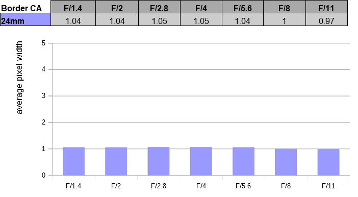

On Sony cameras, you don't really have to worry about chromatic aberrations due to image auto-correction. However, even if you prefer to disable this for whatever reason, the CAs are fairly low at around 1px on the average at the image borders.
