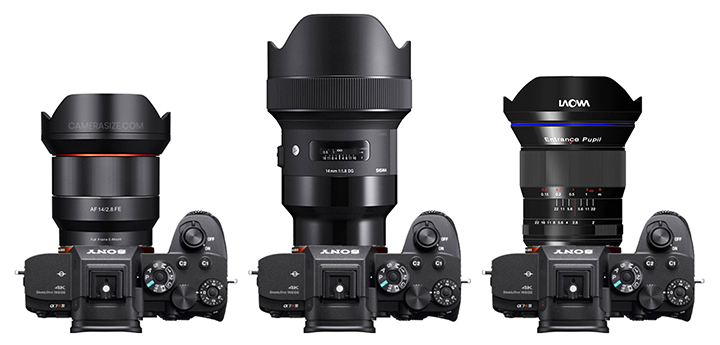

Sony has a couple of (very good) zoom lenses that rule the high-end of the market but there's nothing that comes close to the Samyang (shown to the left) in terms of pricing. If we stretch things a little, we may include the Sigma 14mm f/1.8 ART DG HSM - which is essentially an adapted DSLR lens. Combined with the much larger aperture, it's a HUGE lens in comparison. But ... it is also sharper than the Samyang. Another option - albeit a manual focus one - is the Laowa 15mm f/2 Zero-D. It is more expensive still but also a full stop faster. Optically they are in the same league although we'd give the edge to the Laowa here. The Laowa is also impressively small in comparison.
