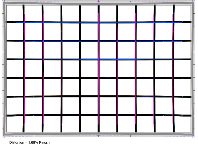

The Sony FE 200-600mm f/5.6-6.3 G OSS has a somewhat unusual distortion characteristic. Very often, there's a switch between barrel distortion at the short end and pincushion distortion at the long end of the zoom range but in this case, there are medium pincushion distortions around the 1.5% mark throughout the zoom range.
With activated image auto-correction, the distortions are perfectly corrected as you can see below.
