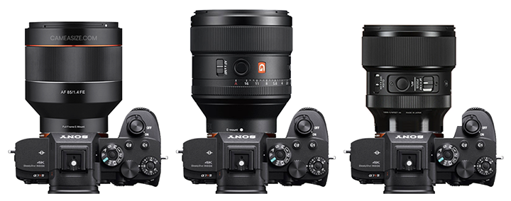

There are currently three 85mm f/1.4 AF lenses available in E-mount, the Samyang AF 85mm f/1.4 FE (to the left below), the Sony 85mm f/1.4 GM (center), and the Sigma 85mm f/1.4 DG DN (right) - and they all reside in their very own pricing slot with roughly a 500USD/EUR distance between the Samyang and the Sigma, and the Sigma and the Sony. This is already making clear that the Samyang lens is the value king here. If photography is just a hobby for you, the Sony GM lens is "a bit" over the top. It may have a certain edge here and there - specifically regarding toughness - but spending an extra grand for this requires quite some enthusiasm ... or the ability to tax-deduct the costs. We haven't tested the Sigma lens yet - but we have little doubt that it is better than the Samyang, and it has certainly better sample consistency and after-purchase service. Still, it's much more expensive.
