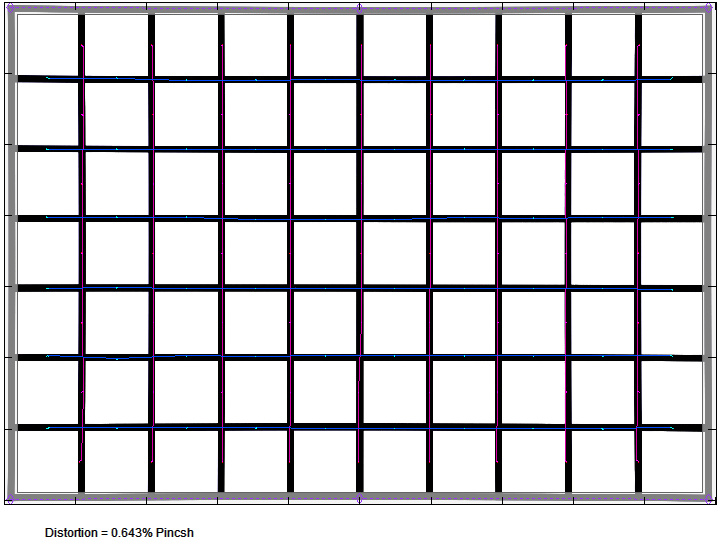

Most users will probably take advantage of Sony's image correction system. If so, you will observe distortion-free images at 28mm and just some marginal pincushion distortions at 50mm and 70mm.
When looking at the native distortion characteristic, things are very different though. At 28mm, there are some medium to strong barrel distortions (2.5%) which is better than on most kit zoom lenses actually. However, the strong pincushion distortions at 50mm (3.1%) and 70mm (3.7%) are much less encouraging.

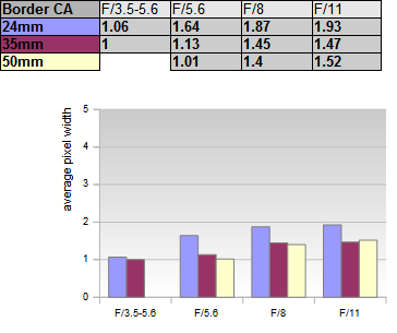

Lateral CAs (color shadows at harsh contrast transitions) are visible but the issue remains acceptable. The CAs are quite low at fully open aperture but increase when stopping down. Unsurprisingly they are worst at 28mm peaking at an average pixel width of 1.9px at the image borders.
