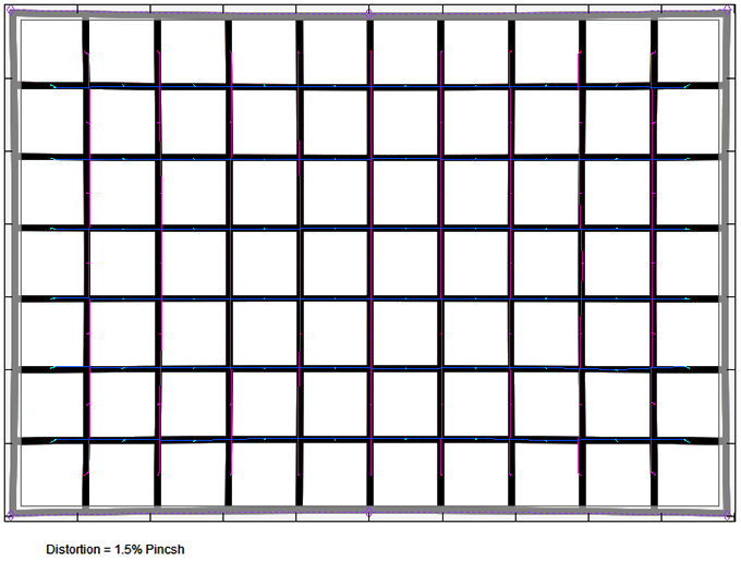

Unlike other mirrorless manufacturers, Canon does not believe in (lossy) digital auto-correction of distortions which is certainly commendable. And they are certainly showing that it is also not necessary by avoiding extreme distortions with little efforts. The Canon EF-M 55-200mm f/4.5-6.3 STM IS produces a slight barrel distortion at 55mm. There are moderate pincushion distortions at 135mm and 200mm but they remain within acceptable limits.
