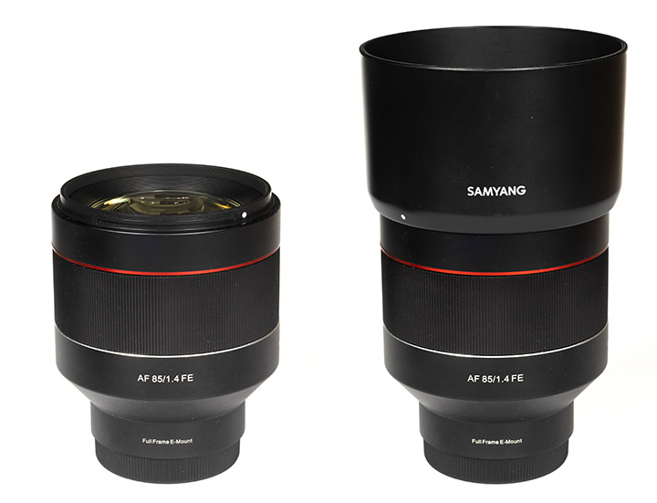

The lens feels surprisingly sturdy with a lens body made of metal. The blank portions have a satin-like finish to them. It's a bit slippery and probably not everybody's darling - but that's mostly a matter of taste. Samyang implemented 3 gaskets for weather sealing. This isn't quite as extensive as on some other lenses but it's reassuring nonetheless. The physical length remains the same across the focus range thanks to an internal focusing system. The broad, metal focus ring operates smoothly. There is no AF/MF switch on the lens so you have to control the focus mode on your camera. A deep petal-shaped hood is provided.
The Samyang AF 85mm f/1.4 FE uses a DLSM or "Dual Linear (Ultra-)Sonic Motor" for auto-focusing. The focus actions are near-silent but the AF speed is a bit on the slow side. Sony's DMF (Direct Manual Focus) is supported - using the usual "focus-by-wire" system. Switching to manual focusing has to be done on the camera as well. An image stabilizer has not been implemented but you can, of course, use the in-camera IS (if available). The lens is compatible with Samyang's "Lens Station" which can be used for fine-tuning the AF and firmware updates.
