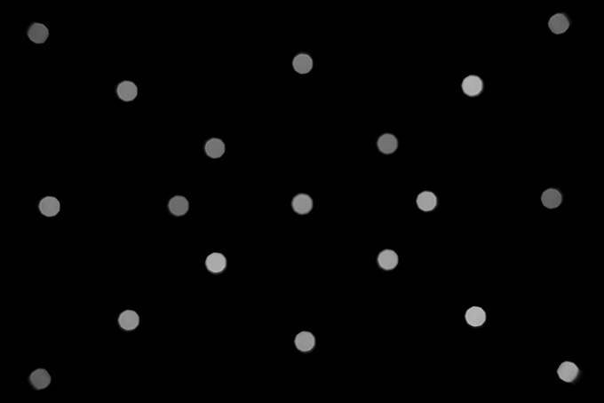

If you invest in an f/1.4 lens, you tend to do it for shallow depth-of-field photography and the quality of the bokeh is important - maybe even more so than sheer sharpness. The Samyang / Rokinon AF 85mm f/1.4 FE has some strengths and weaknesses here.
Out-of-focus highlights are nicely rendered in the image center. They are "feathered" thus creamy at the edges and the inner disc is very clean. Unfortunately, traces of a more edgy aperture are already showing up at f/2, and more so at f/2.8.
The circular shape is also only maintained in a fairly narrow zone in the image center (at f/1.4). The shape deteriorates rapidly with rather pronounced "cat eyes" in the corners. Stopping down broadens the "good" zone in the center whereas the corner rendering isn't ideal. The corner highlights are more pleasing at f/2.8 but still not perfect (besides the general edginess).
