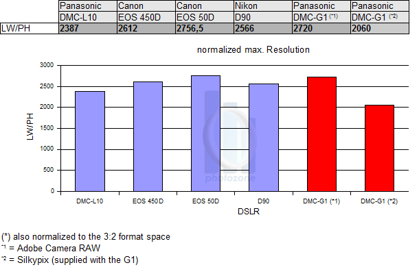

Panasonic DSLRs (system cameras) have an excellent reputation regarding their resolution capabilities and the G1 is no exception to the rule here. The following chart compares the Panasonic DMC-G1 to the Panasonic L10, the Canon450D, the Canon 50D and the Nikon D90, based on RAW files, transformed to DNG and converted to JPG using the same Adobe Camera RAW version.
It is unfair to compare the resolution of a beginner camera with the prosumer class! No, it is not! The maximum resolution of the G1 is comparable to the Canon EOS 50D, a 15mp DSLR! Amazing ... but ... when converting the resolution test image with the included software Silkypix, the resolution shows a different, substantially lower result which is worse than an 8mp DSLR. This is poor and a waste of the very high resolution potential of the camera.
Here're a visual illustrating the different resolution levels of Silkypix vs ACR (move move over the image):
It should be fairly simple to conclude which one belongs to which RAW converter here.
The "formal" max. resolution provided by the Imatest toolkit is in excess of 3000 LW/PH but the LW/PH value (line widths per picture height) is given relative to the vertical scale (also for the horizontal resolution). Thus a 4:3 camera has a numerical advantage over LW/PH figures for 3:2 DSLRs. The chart above shows the normalized values for the usual 3:2 format universe.
